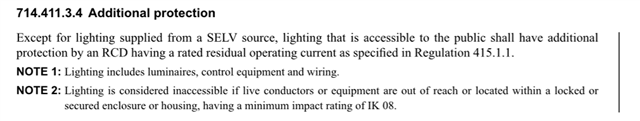

I'm working on a project where we're installing a number of high mast floodlights and lighting columns (6m high) in a big public car park. I'm trying to determine whether these lighting circuits require RCD protection.
BS 7671 isn't entirely clear on this. It states that lighting accessible to the public requires RCD protection, but it also specifically excludes street lighting, so I'm not sure which category this installation falls under. Also, technically  there's the need to balance the use of RCD against the risk of nuisance tripping.

  • This is not the first time confusion has been highlighted.
    Regulation 714.411.3.4 was updated for BS 7671:20-18+A4:2026, and this might help with the decision:

    Each steel lighting column will have a cut-out containing live conductors at an accessible height, but it will be housed within a locked enclosure. Based on that, is it correct to say that, provided I can confirm the lighting columns are IK08 rated, the 30 mA RCD requirement can be omitted? Does that sound like the correct approach?
  • provided I can confirm the lighting columns are IK08 rated
    lighting columns and and any other enclosures used for the lighting installation that are accessible to the public would need to be IK08.
    There is a slight technicality ... I get the impression the project is being executed under an earlier version of BS 7671 (perhaps BS 7671:2018+A2:2022 with or without Amendment 3:2024). If this is the case, technically it's still not fully conformant to the earlier version of BS 7671. There are a couple of issues which might need to be resolved (on paper) dependent on the contract:

  • Yes the site is in the UK. As this is for a private network, the contract is not binding to any BS7671 version but we aim to be compliant with the latest version unless there is a good enough documented reason to take a departure. There is nothing else as per risk assessment for these circuits that would necessitate employing RCDs. Infact all the existing flood lights and lighting columns on site do not have any RCD protection likely because they were installed before BS7671:2018 +A2 which is when I believe this ambiguous requirement was added. Glad that it is clarified in the 2026 version. Thanks again for your help. Much appreciated.
