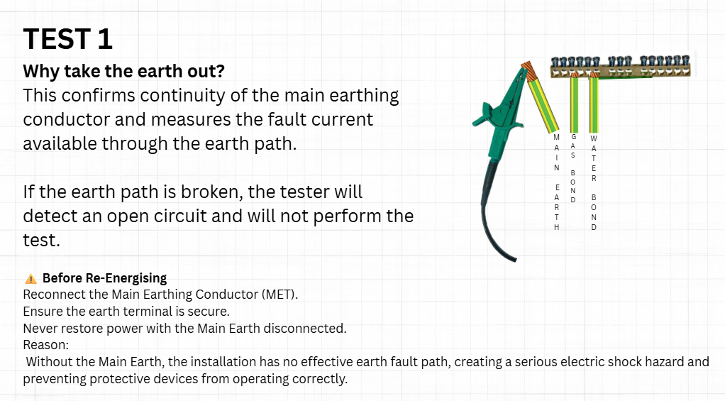

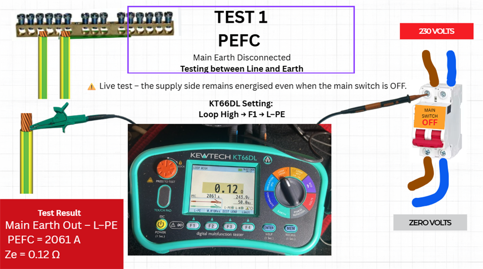

Test 1 – PEFC with the Main Earthing Conductor Disconnected
The first measurement is taken between Line and Earth after temporarily disconnecting the main earthing conductor.
This removes parallel earth paths, allowing the tester to verify the integrity of the main earthing conductor and determine the available earth fault current through the primary earth path only.
If the main earth were broken, the tester would identify an open circuit, and the test would not proceed.

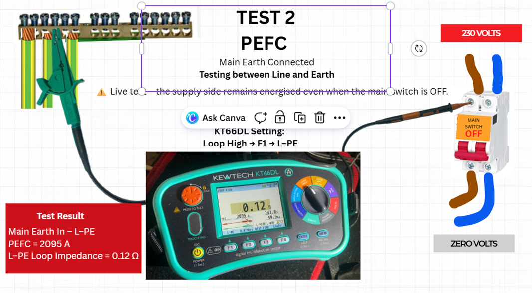

Test 2 – PEFC with the Main Earthing Conductor Connected
The main earthing conductor is then reconnected and the test repeated.
This measurement now includes any parallel earth paths, such as bonded metal pipework or structural steelwork, which may reduce the overall earth loop impedance and increase the available earth fault current.
This represents the earth fault conditions that exist during normal operation.

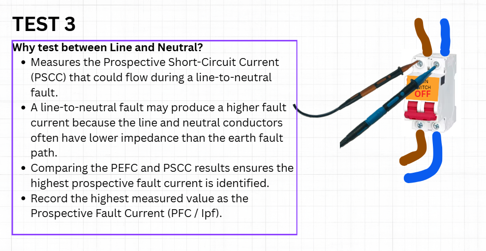

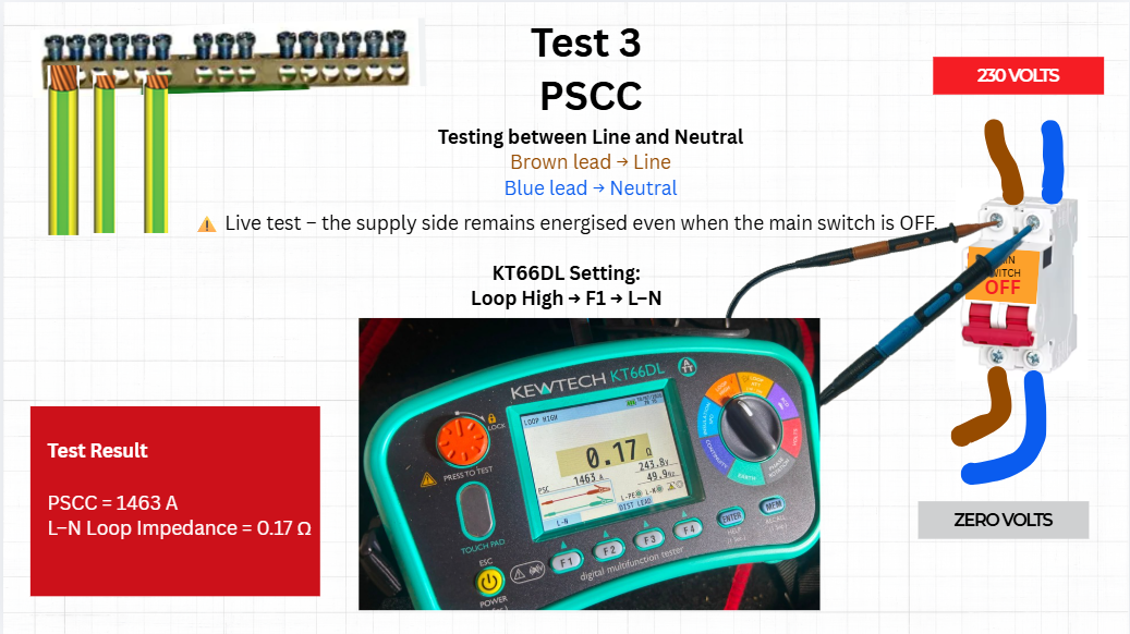

Test 3 – PSCC Between Line and Neutral
Finally, a measurement is taken between Line and Neutral.
This determines the Prospective Short-Circuit Current (PSCC).
Depending on conductor sizes and circuit impedance, the line-to-neutral fault current may be greater than the earth fault current.
For this reason, both PEFC and PSCC must be compared before selecting the final PFC value.

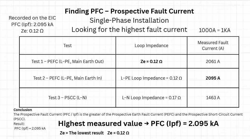

Recording the Correct Value
In the practical example shown in the presentation:

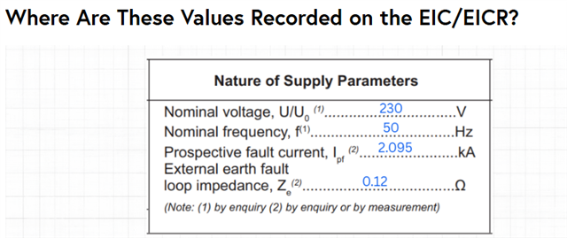

The correct value entered on the Electrical Installation Certificate is therefore:
PFC (Ipf) = 2.095 kA
The Ze value is taken from the earth fault loop impedance measurement, which in this example is 0.12 Ω.
Where Are These Values Recorded on the EIC/EICR?

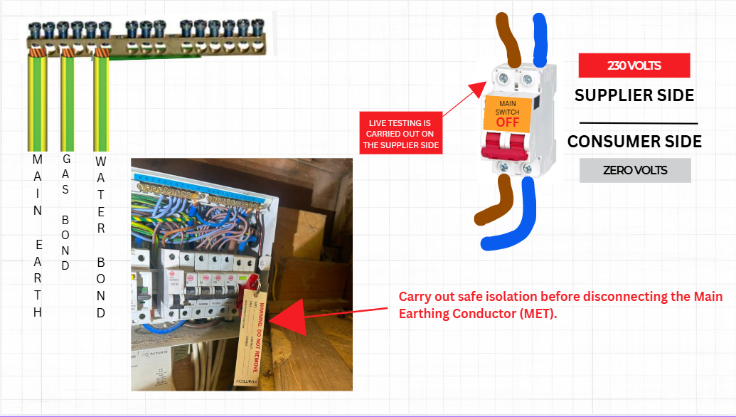

These are live tests.
Safe isolation procedures must be completed before disconnecting the main earthing conductor.
Before restoring the installation:
  • reconnect the main earthing conductor,
  • confirm the earthing terminal is secure,
  • never re-energise the installation with the main earth disconnected.

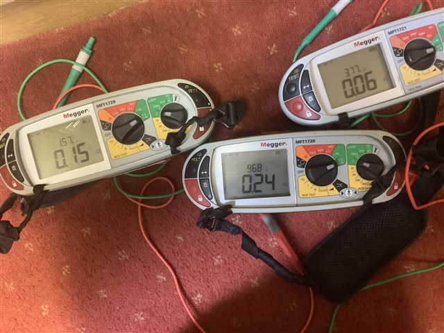

  • And sometimes you might wonder about the accuracy of the result! I have posted this before which was at the intake of an installation within a hundred metres or so from a 11Kv/440/230 500KVA tx.  We were just experimenting with the instruments we had on site that day. Multiple tests with leads swapped around. Hardly laboratory conditions but it does throw a bit of a spanner into the reliability of results.
    In 25 years running an inspection and testing business, I cannot think of a situation where the pfc was worrisome because it was high, rather the opposite when applying it to assess thermal capacity of cables.

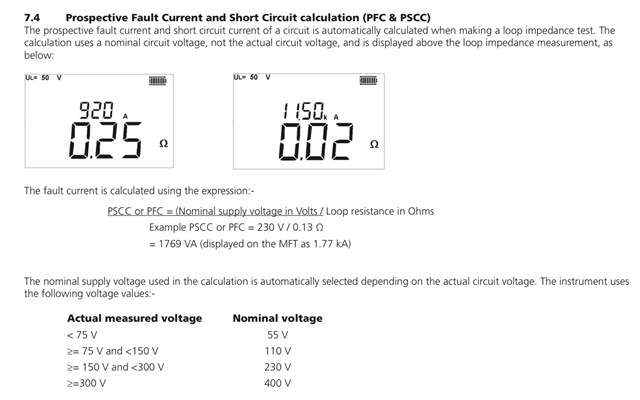

  • The PSCC is calculated by the Megger MFT using a nominal voltage rather than the precise voltage.
    portalvhds963slh4m3fqg2.blob.core.windows.net/.../MFT1700_UG_en_V06.pdf
