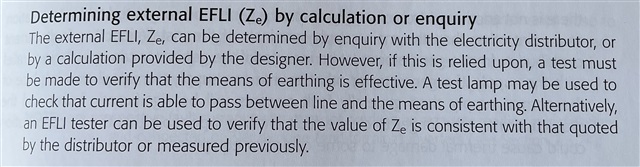

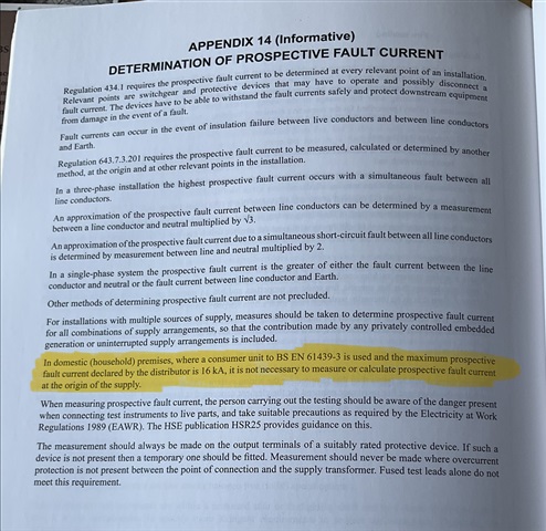

Warning️ Practical Consideration (UK Practice)
Image courtesy of   (IET EngX discussion).
Although measuring PSCC forms part of the general method for determining the Prospective Fault Current (PFC), direct Line-to-Neutral testing at the origin is not always necessary or recommended.
For many typical 100 A domestic installations fitted with a BS EN 61439-3 consumer unit with a 16 kA conditional short-circuit rating, BS 7671 Appendix 14 and IET Guidance Note 3 recognise that the prospective fault current may be determined by enquiry, calculation, previous verified data, or other suitable methods, avoiding unnecessary live testing.
Where direct measurement is required, it should be carried out downstream of a suitably rated protective device, not directly on an unprotected supply.
Key Learning:
Understanding when a test is required is just as important as knowing how to perform it safely.

  • Industry best practice is considered to be to test and record the PSCC and generally you will be expected to test and record the PSCC, but it isn’t recommended in BS7671 or GN3 within domestic installations and you must be very careful.
    When you are testing you are shorting out the incoming supply and if there is a flash over it will melt steel, copper and plastic, when electricity goes bang it doesn’t mess about, it really does go bang.
  • Not if you obtain a value by enquiry. (313.1).
  • PSCC testing is dangerous, as you are shorting out the incoming supply and the IET Guidance Note Three’s, both the brown and orange editions, advise that you should not rely on fused test leads for your safety and you should test downstream of a suitably rated protective device, and if there isn’t a suitable device in the consumer unit then you need to go and get one out of your van and temporarily install it to give you the additional protection you require.
    What about the DNO's 100 A (could be less) fuse?
  • Chris Pearson commented about Ze testing, you don’t have to measure Ze, but having carried out safe isolation and disconnecting the main earth for testing you might just as well use your loop tester and get a measurement, rather than just using a test lamp to confirm it is actually connected, and again, testing and recording the measurement is considered to be best practice and is what you will be expected to do.
    Having said that, I have found installations where electricians have connected to the earth terminal on a DNO intake without checking it was actually connected, which they could have done with just a test lamp.

    I agree that there is no need to know PFC in an ordinary dwelling. 16 kA would only flow at 230 V if the impedance were less than about 14 mΩ which represents less than 10 m of 25 mm² copper, or 35 mm² aluminium (OSG Table I1), so might just be achived if the transformer is next door.
    The reason that I mention Ze is that I want to be assured that it is low enough to blow the fuse in the service head should something drastic happen.
    When I measure Ze, my MFT also gives me the supply voltage and calculates the PEFC. If the supply is TN-C-S, PSCC = PEFC, so job done.
  • Having said that, I have found installations where electricians have connected to the earth terminal on a DNO intake without checking it was actually connected, which they could have done with just a test lamp.
    That is rather worrying. I wonder whether the installers were being lazy, or did the DNO intend that the earth would be TT.
