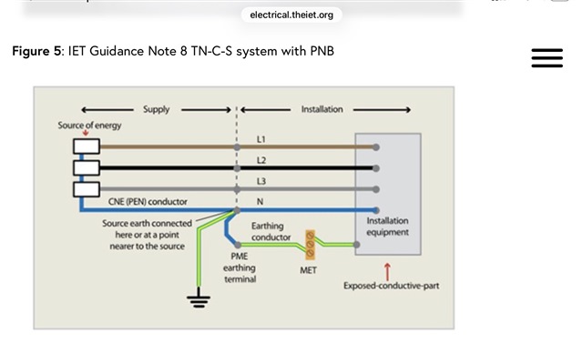

  • The principal is the same, a very basic polarity test will confirm if an earth is connected or not, as it says in IET GN3 regards testing the earth terminal provided by the DNO.
    However, at the main intake you have to confirm it’s not a parallel earth path and the DNO earth terminal is actually connected to the DNO network.
  • Something to consider.

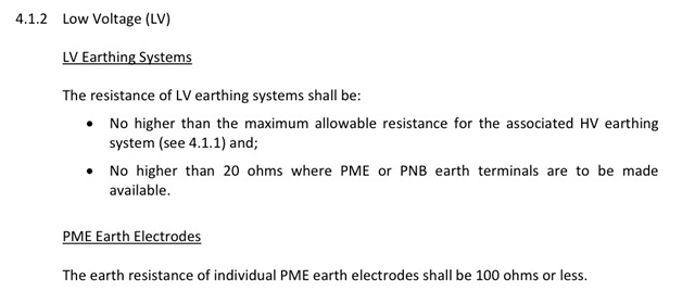

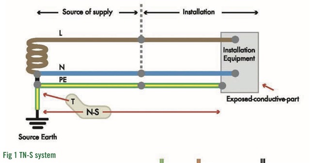

    What should be remembered is that in a TN earthing system you can confirm the the earth terminal the DNO have supplied for use by their customer is connected to the PEN conductor in a TN-C-S system or the network earth conductor in a TNS system, but when you test Ze on either TN system you don’t actually confirm that the DNO network LV earthing system is connected, so you have to trust that the DNO are keeping the network Low Voltage earthing system in good condition.
    Even if the DNO network earthing is in good condition, the resistance on the DNO earthing system tying the PEN/earth conductor down to true earth could be up 20 ohms, despite the electrician measuring less than 0.35 ohms on the provided earth terminal.

  • When you test at the installation lives, neutral and PME earthing terminal the underground DNO earthing conductor and rods or mat are not part of the circuit you are testing, so you have absolutely no idea if it is connected or not.
    The groundworkers could have ripped through buried earth conductor trenching for a pipe or it could have failed for some other reason, so although you may have obtained a good Ze test result the whole earthing system could be floating and not connected to true earth.

  • The same applies when testing Ze with a TNS earthing arrangement, the DNO transformer earth connection to true earth is not in circuit and can have a resistance to true earth of 20 ohms.
