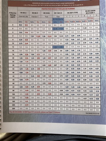

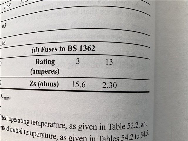

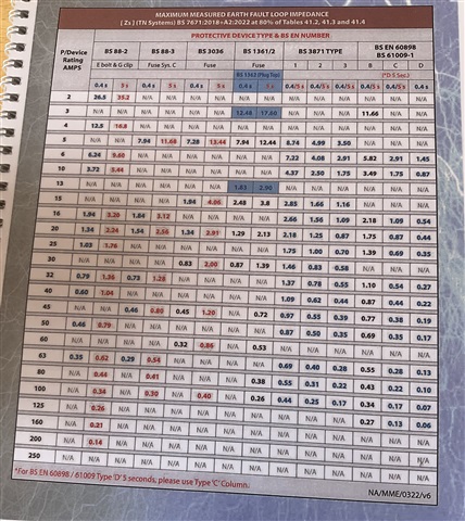

  • Quote “The KewTech reports all the connections are present, (so earth is connected for the circuit), but it is saying "Check loop test" because it has detected a safety earth path between 1.80 ohms and 92 ohms.”.
    The answer as to why the range limit is 1.80 ohms is actually fairly obvious if you think about it and have a look at the tables in BS7671 and other guidance.
    2.3 X 80%=1.84
    and it is a 13-amp socket tester.

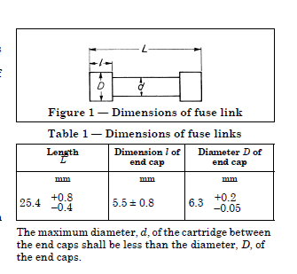

    A chum of mine turned up a very neat little brass bar to the exact dimensions of a BS 1362 fuse
    Cutting an inch of 6.3 mm nominal diameter brass bar often measures up very well when you get the calipers out, as I've done myself for some lab tests on samples of products intended for BS 1362 fuses. From Clause 5.8 of BS 1362:
