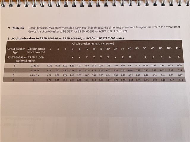

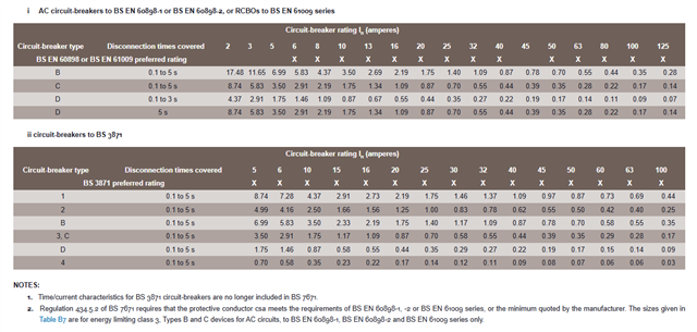

  • Quote “The KewTech reports all the connections are present, (so earth is connected for the circuit), but it is saying "Check loop test" because it has detected a safety earth path between 1.80 ohms and 92 ohms”
    What is the issue?
  • What is the issue?
    90 ohms is greater than 5.83  Ohms ... there is no RCD as far as we know ...so we don't know whether it's got sufficiently low earth continuity/lopop impedance.
    Also, are we sure we're on the right part of the table, we don't know whether the circuit-breaker is  BS EN 60898 or BS 3871 Type B, or BS 3871 Type 1 (as   earlier identified ,7.28 ohms limit), but similar conclusion "don't know whether it's OK".
