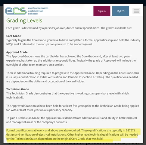

Touching on a subject in another thread, a Technician was doing an EICR at a domestic premises. He didnt have 2391, and, as far as I could find out, he didnt have a great deal of experience either (I was there to see the Apprentice he was supervising).
It has always gone on, and will probably still go on when the new guidance about a 2391 is required to do EICRs come sin in September (October?). My query, having not read in depth about it, can a QS / Manager, with 2391, send out his non-2391 workers to perform the EICR, then he signs it as the QS with his 2391?

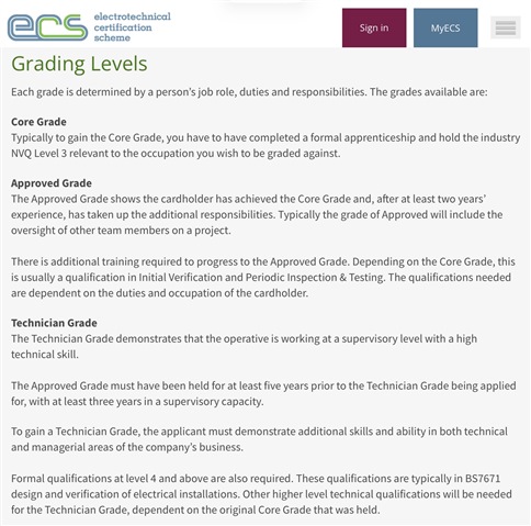

  • Should any electrician who wants to be the Qualified Supervisor of their own or any other electrical contracting company have to have a City and Guilds Design, Erection and Verification Qualification?
  • That would be a step forward. But it doesn't address the problems of poor installation. No one is going round checking the work, as, basically, there are not enough Inspectors. The Governing Bodies, and Council Building Regs people are relying on the Self-certifying Companies doing the work properly in the first place. We know that is not working properly, as corners can be cut, and no-one ever catches the people who do it.
    Most of the problems I've seen are done by people/Ltd. Co's who are NICEIC Registered, employing 'Gold Card' Electricians. This should be enough to ensure a good quality, safe , reliable, compliant job. But some are just not bothered about a good safe job, if it works, it's enough for them.
    No, but as Alan suggests, it would help. The competent person schemes like NICEIC and NAPIT are bound by the Electrotechnical Assessment Specification. Currently to apply to be a QS for your own or another company, where you haven’t been a QS in the last 2 years, you will need to hold qualifications appropriate to designated work categories. Generally speaking, for such a candidate, you will need an appropriate NVQ L3 or other recognised historical qualification along with AM2. If the QS will be involved in periodic inspections, EVSE, PV or battery installs, then further qualification requirements apply.
