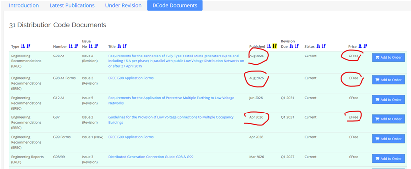

  • No need to wait The August version of the G98 and much other updated Dcode stuff can be downloaded by anyone right now.
    Head over to https://www.ena-eng.org/ena-docs/index  and login, or if you dont have an account register, then login.
    Once logged in click on the Dcode header and add to basket as many free docs as you wish to read, My choices are highlighted here, yours may differ.
    As those ones are free, when you head to ' view  basket' then confirm order and so on, they will be emailed to you  for free, after about a 5 min delay in my experience.

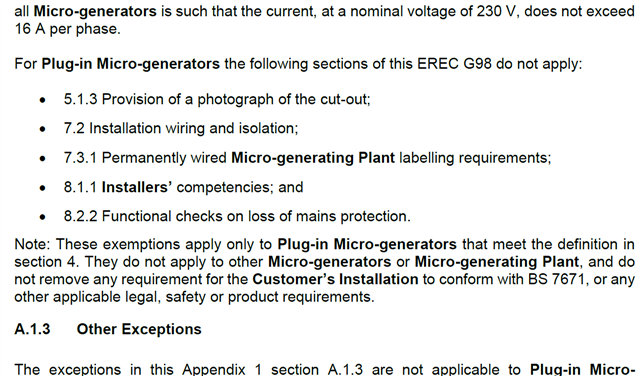

    The new bit of G98 is mostly in the  annex. but odd references elsewhere
    example.
    I suggest anyone interested takes a look at the actual document, there is a lot of misleading twaddle on some parts of the web at the moment.
    There is also a new "B2" form to be used to register new plug in systems, and a new unplugging form as well, the install form looks like the old B form, but removed the installer section and currently has a 'no more than one Plug-in Micro-generator is connected in my premises' clause, but I do wonder if that may well vanish or be replaced with 'per circuit'  in future updates to align with the DENZ guidance.
