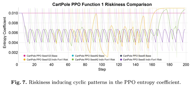

It did not taper off smoothly from high to low in the way a fixed schedule assumes, but oscillated in waves instead. The agent would settle into exploiting what it already knew, encounter a state that surprised it or looked risky, increase its exploration sharply at that point, and then settle back down again once conditions stabilised, before the cycle repeated at the next point of genuine uncertainty. This behaviour was not programmed into the system or agent; it emerged from the agent reading its own uncertainty as training went along. The pattern was seen consistently across several different starting points (called 'seeds'), each showing the same up-and-down rhythm on its own, so it appears to be a real, repeatable pattern of the agent's learning rather than a fluke or noise.
The exploration coefficient, labelled 'entropy coefficient' on the chart, plotted over the course of training. Riskiness is the specific signal driving the adjustment here, the same "gap between the best-valued action and its worst-case one" described above. The test itself was run on CartPole, a simple task where the agent balances a pole by moving a cart side to side, using PPO, one of the two training algorithms used in the study. Labels like 'Function 1' and the different seed numbers refer to specific experiment settings and can be ignored here. What matters is that the coefficient rises and falls repeatedly rather than decaying smoothly, as the agent responds to risk in real time. Source: Quintana-Amate et al., "Explain to Gain: Introspective Reinforcement Learning for Enhanced Performance," Fig. 7.
It is a slightly odd thing to picture at first, a machine's willingness to search rising and falling repeatedly, and following a seemingly complex strategy rather than a simple rule like a fixed schedule. But it makes sense once you think about what a fixed schedule is actually assuming: that the value of exploring is highest at the start and lowest at the end, when in fact the value of exploring at any given moment depends on how well the agent currently understands the specific situation it is in, and that understanding does not improve at a constant rate. Some parts of a task stay genuinely uncertain much longer than others, and some previously well-understood parts can become uncertain again if the situation shifts. A schedule fixed in advance has no way to know any of that, whereas a system reading its own uncertainty in real time does (though the same research also found the agent can sometimes be too quick to react, adding some variance).
