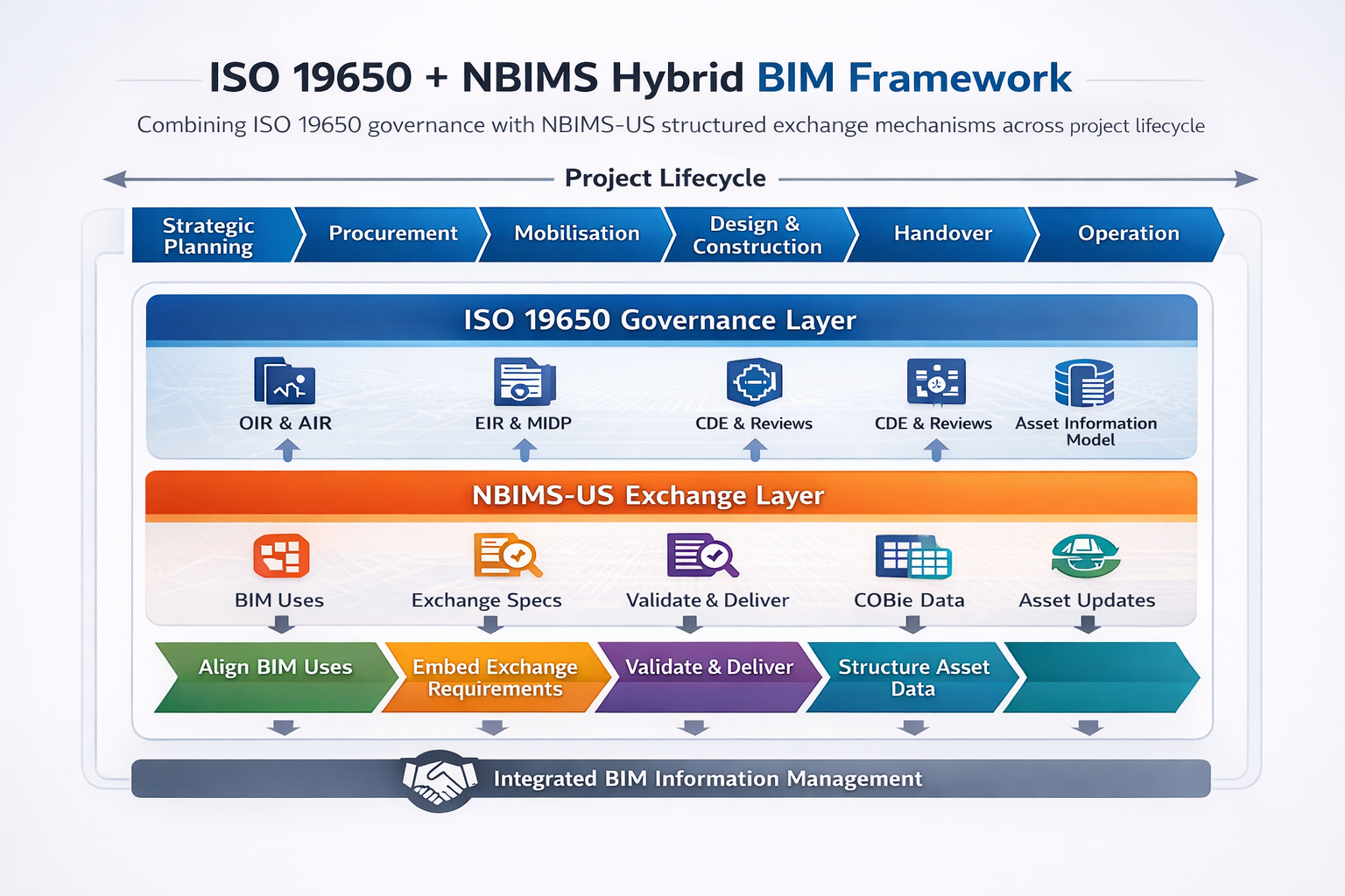

A hybrid perspective on BIM information management
When we examine ISO 19650 and NBIMS-US together, an interesting insight emerges.
Instead of choosing one framework over the other, it may be more productive to view them as two complementary layers within a BIM information management strategy.
In such a hybrid model:
  • ISO 19650 provides the governance backbone
  • NBIMS-US strengthens the structure of information exchanges
This layered approach allows governance decisions and structured deliverables to align throughout the project lifecycle.
Project Stage
Governance Layer (ISO 19650)
Exchange Layer (NBIMS-US inspired)
Integration Benefit
Strategic planning
Organisational and asset information requirements
BIM use definitions
Align digital strategy
Procurement
Exchange information requirements
Structured deliverable expectations
Clarify data needs
Mobilisation
MIDP / TIDP planning
BIM execution planning
Coordinate delivery
Production
Information containers
Model deliverables
Improve consistency
Review
CDE approval workflow
Exchange validation
Strengthen data quality
Handover
Asset information model
COBie datasets
Reliable asset data
Operation
Lifecycle governance
Structured asset information
Support facility management
Through this integration, project information becomes both well governed and technically usable.
