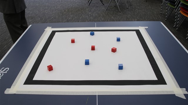

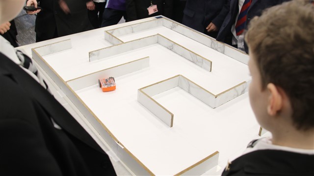

The three programming challenges were to make the robot navigate maze, to make the robot clear a set of wooden blocks from an 800mm x 800mm square, and to make the robot navigate around two concentric squares, 480mm x 480mm inside a 960mm x 960mm square.
A significant engineering challenge which the students found was that the robots are not very precise. When asked to turn through 90 degrees, the robot may turn though somewhere between 70 and 110 degrees. The students found that by recalibrating the robots, they turned more accurately, and that making the robots turn more slowly also improved accuracy.

All the teams’ robots performed well, and a number had novel and clever designs. One robot program worthy of special mention was the design created by the team from Blundells School in the block clearing challenge. Their design “hunted” for a block to clear by moving forward in leftward and rightward steps until a block was detected, then the block was pushed to the edge of the square, before reversing to ensure the block wasn’t moved back into the square.
