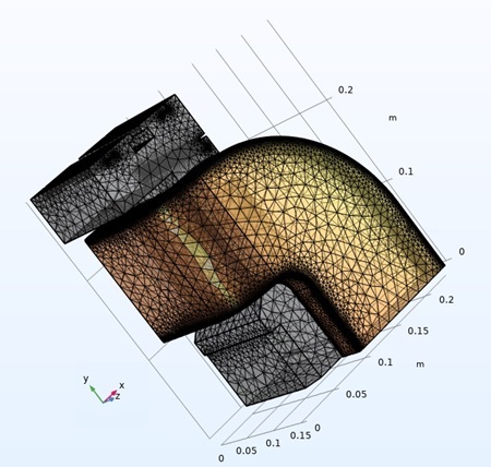

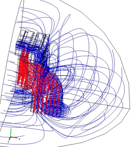

We modeled the magnet in both 2D and 3D, exploiting symmetry to reduce computational domains (e.g., quarter-section in 2D, eighth in 3D). The 2D model, with a mesh of ~268,000 triangular elements, was ideal for quick iterations on local properties like f1 and f4. For integral quantities (f2, f3), 3D models (~75,000 tetrahedral elements) captured end effects and fringe fields, using the magnetic vector potential formulation:
∇×(ν∇×A)=J

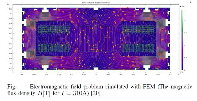

Boundary conditions included magnetic insulation on outer surfaces and symmetry constraints (Dirichlet on one axis, Neumann on another). Nonlinear material properties were incorporated via the B-H curve, and current densities were defined subdomain-wise (e.g., helical approximations in coils).
Simulations ran for excitation currents from ±15.5 A to ±310 A, revealing field distributions with peak densities near poles and uniformity in the good-field region. For instance, at 310 A, the central B-field matched measurements within 0.1%, highlighting COMSOL's accuracy in predicting saturation and flux leakage.

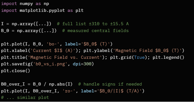

Local Excitation Curve Processing Script loads currents I and central fields B₀, computes normalized f₁ = B₀/I, and plots:
  • B₀ vs I (linear-ish with saturation at high |I|)
  • B₀/I vs I (shows permeability drop due to saturation)
Code example (simplified):
This revealed hysteresis minimal and saturation onset, with f₁ stable ~0.00109 T/A at low currents.

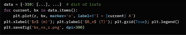

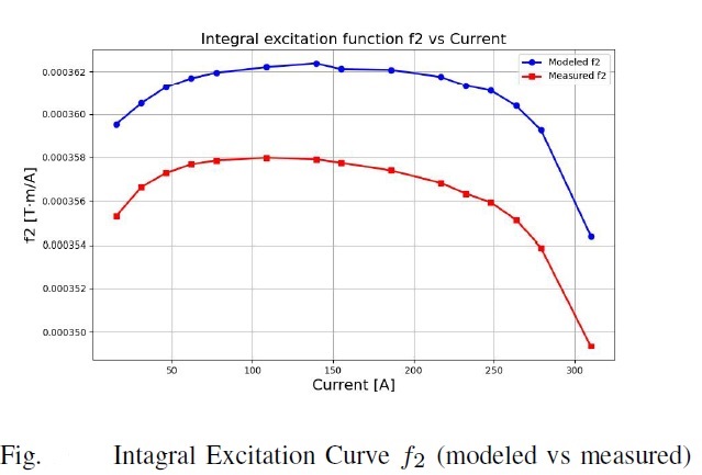

Integral Excitation Curve For longitudinal profiles, scripts plot B_x(z) for selected currents (symmetric positive/negative), then compute integrated BL/I separately for positive/negative ramps to check consistency.
  • Multi-line plot: B_x vs z for I = ±62, ±186, ±310 A shows good symmetry and end roll-off.
  • BL/I vs I plots: very flat (~0.000333–0.000335 Tm/A), confirming effective length near-constant.
Code snippet for multi-current plot:

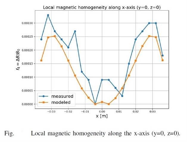

Local Homogeneity Analysis Most advanced scripts compare transverse profiles (y-axis, -0.036 to +0.036 m):
  • Interpolate central B₀_model and B₀_meas.
  • Compute ΔB/B₀ for both.
  • Relative error: (measured - model)/model * 100%, with stats (mean, max, min printed).
  • Plots: ΔB/B₀ overlaid, error % curve, with ±0.01% limits and markers for exceedances.
  • Additional: loadtxt from .txt files for normalized deviations at specific positions (ex. 33 mm variants).
Example stats output: mean relative error ~0.4–0.6%, max <1%, confirming uniformity within tolerances in central region.

  • Integral Excitation: Errors <1.5%, but Python highlighted larger discrepancies (~11%) at magnet ends, attributable to fringe effects—prompting model refinements.

  • Homogeneity: Field uniformity within ±0.5% in the good region; Python's error plots showed peaks at low ΔB points, but overall agreement confirmed design tolerances.

Comparisons showed 2D models suffice for transverse properties, while 3D is essential for longitudinal integrals—guiding efficient simulation strategies.
