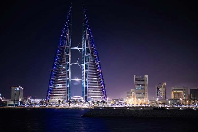

Today, the latest part of that push opens…the Bahrain World Trade Center, the first skyscraper on the planet to incorporate wind turbines.
Depending on the angle from which you see it, the building could look like a giant pair of schematically drawn lungs sitting on the Manama waterfront. From other angles, it looks like a pair of lateen sails of the sort seen on arab dhows. Or it could look like a pair of massive towers defending the gatehouse to a city imagined in a science fiction novel. Either way, it has a strong sense of the futuristic.

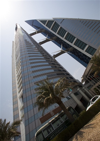

As a result, there are now three horizontally mounted wind turbines set on aerodynamic 'skybridges' between the towers. These were designed and built by Danish companies Ramboll and Norwin. Designers had to contemplate issues such as materials, load, vibration, and noise. Designed for a lifespan of twenty years, each 225-kw turbine has a twenty-nine-metre diameter and weighs in at sixty-eight tons, producing 1100 Megawatt hours of power, or up to 15% of the BWTC's requirement. The installation was carried out in 2007, while they were first turned in 2008.Towers viewed from below
Control centres within the towers operate each turbine, with small cranes used to maintain and repair them. Another design feature of the turbines was the cost – they are relatively cheap, coming in at 3.5% of the building's eventual price tag instead of up to 30%, which had been a feature of previous similar projects. Using off-the-shelf technology was a big help in keeping down the outlay, which was part of the building's main selling point.
