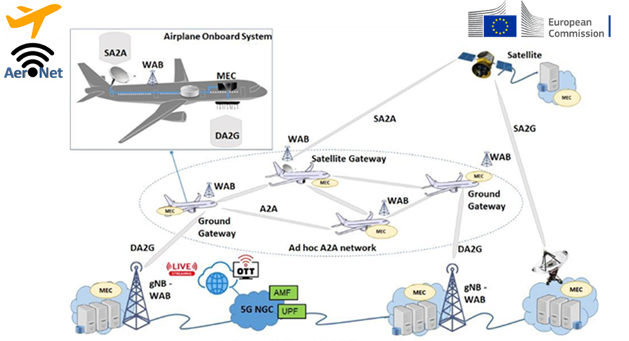

The "AeroNet" project, recently awarded under the Marie Skłodowska-Curie Actions Staff Exchanges (SE) call within Horizon Europe, exemplifies a forward-thinking interdisciplinary initiative dedicated to revolutionizing in-flight broadband connectivity (IFBC). Its primary aim is to push the boundaries of existing communication standards beyond 5G, fostering the development of innovative, resilient, and scalable aerial network solutions that deliver seamless, high-capacity services to aircraft traversing land and sea as shown in Figure 1. By integrating cutting-edge antenna technologies, advanced radio protocols, spectrum management strategies, and intelligent network control systems, AeroNet seeks to bridge current gaps in aerial communication—particularly high latency, limited data rates, and protocols ill-suited for high-mobility environments.
