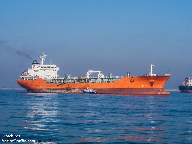

    You can see a D&K Antenna on the starboard side of City of Durban/GXIC here https://photos.marinetraffic.com/ais/showphoto.aspx?shipid=924471
    Plus a INMARSAT Std-A on the port side. Pity that the funnel was not made out of fibreglass.......
