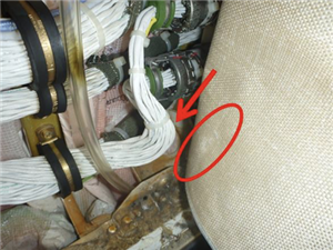

When wiring adjacent to seat 3D, on the opposite side of the cabin, was examined there was evidence of chafing between the wiring and the electromagnetic protection blanket.
EWIS Chafing on Opposite Side of Cabin – Azul Linhas Aéreas Embraer ERJ-195AR (ERJ-190-200 IGW) PR-AUO (Credit: CENIPA)

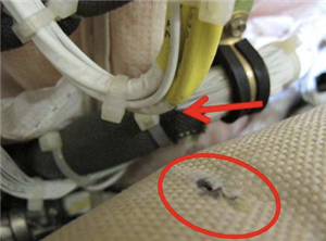

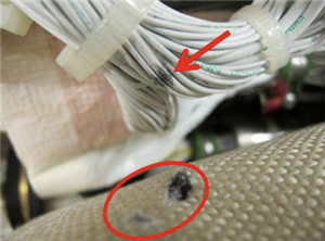

Investigators then examined PR-AUM and PR-AUP, two aircraft with serial numbers close to that of the PR-AUO.  Further chafing was observed on both those aircraft.
EWIS Damage – Azul Linhas Aéreas Embraer ERJ-195AR (ERJ-190-200 IGW) PR-AUM (Credit: CENIPA)
EWIS Chafing – Azul Linhas Aéreas Embraer ERJ-195AR (ERJ-190-200 IGW) PR-AUP (Credit: CENIPA)

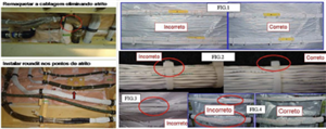

CENIPA verified that there were appropriate production instructions for wiring installation but that production quality deviations had occurred on the aircraft examined.
EWIS Build Instruction Example for Embraer ERJ-190 Series (Credit: via CENIPA)
