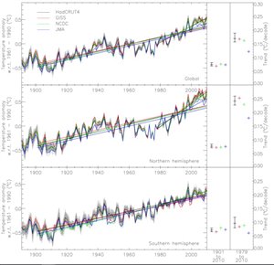

    The UK Met office published a nice set of graphs, HadCRUT, showing global temperature increases. They stopped updating this in 2010 when the flattening was becoming obvious. Interestingly the Japanese numbers were significantly below the others at this point. The graphs also show the deviation increasing between the northern and southern hemispheres. Why should this be? If CO2 was responsible it should be reversed as the concentrations from the OCO2 satellite show higher concentrations in the southern hemisphere (this satellite was launched to ‘prove’ that the main source of CO2 was the industrial areas. After this appeared not to be the case all went quiet.)

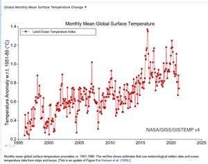

    The only current graphs I can find are from NASA GISS.
    https://data.giss.nasa.gov/gistemp/graphs_v4/
    Between 2010 and 2020 the global  temperatures and the northern hemisphere temperatures climb rapidly. The southern hemisphere continues on a fairly steady climb. What is also interesting is that the ‘Monthly Mean Global Surface Temperature’  graph shows a steady decrease in the last year. Both sets of graphs appear to be based on land and ocean data and use the same baseline. Is one real and one for publicity? Looking at this there may be a climate problem, but certainly not an emergency.
    0cbd008a66b2c78944c6adcdc24b6ceb-original-monthly-mean-global-surface-temperature.jpg
