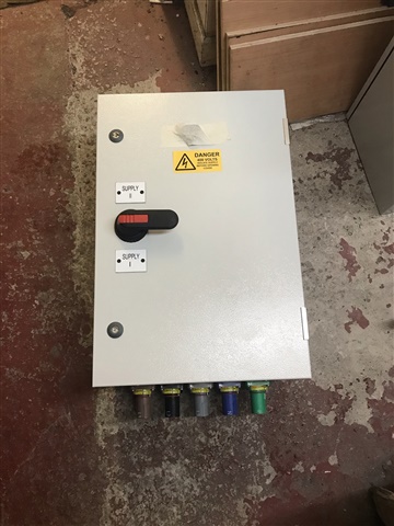

yes the powerlocks singles are pretty solid and the easiest way to parallel up the sets, though you need a socket set to install tails initially to the bus. This is not that set of tails, but a 63 amp one for illustration only
We have this equipment in place. However, when the hired 500 or 1000 kVA generator arrives, it remains on the trailer. The 240mm tails are extended and connected. The substation’s LV room is equipped with earth rods connected to the MET, but no additional earth rod is installed. What are your thoughts on this practice?
well you are then doing what we are more or less - providing a local earth (terra firma) reference for the earth (CPC of the installation. )
What you should not do -in a power cut anyway - is rely solely on the suppliers earth as you don't know what has come disconnected to cause the power cut, but as your LV room has local electrodes so that is not an issue, I suppose one should ask where the NE bond is, but I presume at the genset, so the singles cannot be earth leakage protected unless the NE bond at the mains incomer is disconnected.
Do you ever synchronously parallel run the genset with mains, or is it always a hard switch-over ? The box does not appear to be wired in, so I assume that was a pre-install photo!!
Mike.
So, In the event of a mains failure, the backup generator is activated via an automatic changeover switch. Should this generator also fail, the hired generator becomes necessary, and the generator Veam connection unit is switched to position 2 to facilitate the connection and operation of the hired set. The neutral-earth (N-E) bond at the mains incomer remains connected. All isolators are three-pole, with the neutral-earth bond located in the LV panel board (PNB) and the transformer situated in the adjacent room.
The genset operates with a hard switch-over, rather than in synchronous parallel mode. Additionally, this is a pre-installation pic. The earth rods within the LV switch rooms are tested annually using the clamp meter method. The hired set remains on the trailer but is equipped with an earth rod, which may not achieve a very low reading. Would it be advisable to install an earth pit/nest for the hired set to connect to as well?
Is that like Fig 44.10 in BS 7671 then? OK, not quite as you have the lines switched, but in terms of permanently connected N and PE links? Or is the auto change-over switch 4-pole?
Hi Andy. The ASCO changeover is a four-pole switch. According to note 44.10, switching the neutral helps prevent electromagnetic fields caused by stray currents. Have you ever observed the effects of such an occurrence in an installation where the neutral-to-earth links from both sources remain connected?
