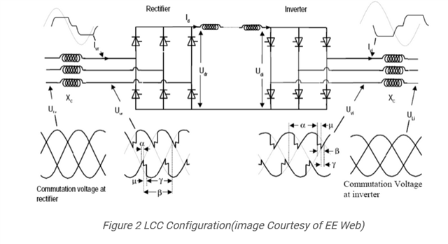

    I'm also not sure if this includes waveform quality correction here - I suspect the inverter derived wave-forms are a lot dirtier in terms of square edges  than sine-waves from rotating magnets.
    Certainly both the line- and self- commutating thyristor based DC link stations generate some pretty unpleasantly rectangular current bursts and rely on other grid elements to spread what are in effect  current impulses more uniformly across the cycle. In the hopelessly simplified circuit below the upper wave-forms near the in and out terminals illustrate this. (The pale grey sine is voltage and the darker bumpy thing represents the general form of the current into or out of the grid)
    Instructions always say that a low impedance grid is needed to keep the voltage waveform from becoming more like that of the current. (sometimes expressed as harmonic content vs supply impedance)
    Removing e.g. the French AC connection and leaving a large DC station on would perhaps  have been problematic in this way

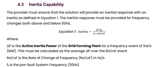

  • for reassurance, look here www.neso.energy/.../reactive-power-market
  • Thanks for that link. Looking there & finding
    Publicly Available 1 Voltage Technical Requirements and Specification
    and
    Publicly Available Stability Technical Requirements and Specification
    Is actually only partly re-assuring - the  circulating current problems of waveform quality (things that are really not simple sine-waves) and phase shift are not separated, indeed reactive power is purely considered in terms of the fundamental frequency, with no mention of harmonic content
    e.g.
    " Reactive Power The product of voltage and current and the sine of the phase angle between them measured in units of voltamperes reactive"
    For now, its good that it is being discussed but the technical language is still that of a traditional rotating grid where changes in frequency are synonymous with a load response...
    An inverter based system need not present any RoCoF with load, or indeed you could design it to give a negative one, if you like.

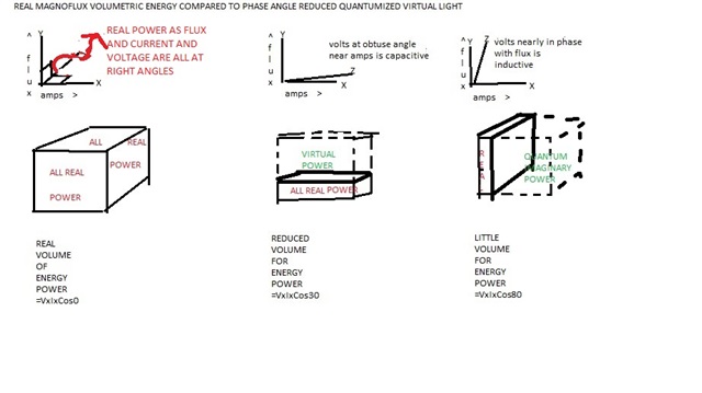

  • Electrical energy per cycle, is a volume of rotating Magnoflux inertia with voltage at right angles to current and both at quadrature to the flux or a Cosine quantum reduction will occur as VAR's.
    Not sure how above Equation 1  helps resolve the problem of cubic volume synchronisation ?

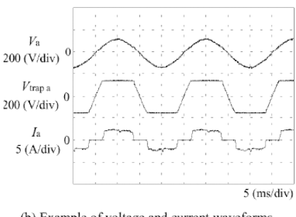

    We just need to be very clear what we ought to be sensing and correcting for. Voltage and current Sines/ cosines shifted in the manner of KVAr are one form of correction required, flow reversals mid cycle to maintain a sine-wave shape from non sine-wave generators are quite another.
    Certainly where I am now has lots of IT kit and lots of LED lights, and the voltage is quite trapezoidal. Not as bad as the experimental waveform shown here but getting on that way.
    Mike.
  • Mike,
    Just thought of an interesting experiment.
    If we charge up a large capacitor then set up magnets at right angles across it; could we then AC vibrate the flux/current energy out of the capacitor somehow?
  • There are a several  devices that rely on moving charges about in crossed magnetic and electric fields.
    A capacitor carrying an AC behaves very much as an extension of the conductor that supplies it, and if you organize a current transformer around the dielectric you will see the same current - this "(charge) displacement" current that represents the periodic reversal of the E and D fields is what we make use of in radio antennas.
    The whole process is reciprocal, so one should be able to place the capacitor with a wire emerging at each end,  into the eye of a toroidal transformer and induce a current to flow in it, with a virtual AC voltage source in series with it. There is no free lunch though, as soon as you allow current to flow and do work, the impedance of the transformer primary will fall and consume energy from the exciting circuit.
