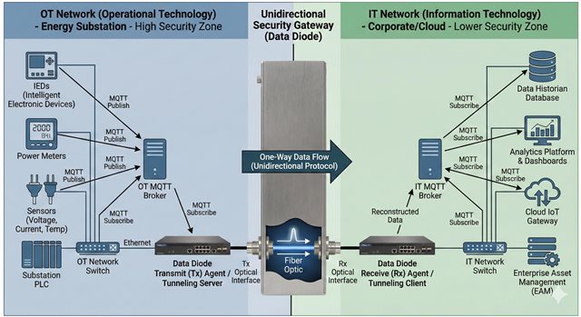

  • Hi,
    Very interesting post.
    What you would make of this option below ?
    The MQTT protocol is the only thing flowing into the IT network via the data diode.
    Note: of course we need to have specific hardware to translate MMS (Manufacturing Message Specification) to MQTT for things like IEDs.
    OT_IT
    Updates are done via an air-gapped cloud infrastructure(on a separated connection only open at specific time slots). Basically we effectively "trip the breaker" between our office environment and our power controls.

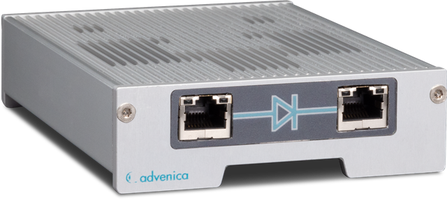

  • Humm. I rather like the idea of a "data diode" but I'm not sure how it would work in practice. Just about any reliable protocol I can think of has some means of confirming safe arrival of the data (and therefore triggering re-transmission if it didn't) - therefore needs a reverse data flow of some kind in order to operate at all. Once there's a reverse path in existence, there's the opportunity to use it for mischievous means.
    MQTT presumably runs over some other protocol (often TCP/IP but could be other I suppose) - which means you're also at the mercy of any vulnerabilities of that layer of software (and all those below it). Hopefully the day of crude memory injection simply by passing oversized packets are over, but still vulnerabilities in such layers are far from unknown. Never assume that just because something was intended to operate in some way, it can't be "persuaded" to do something quite different.
  • usually 'professional'  data 'diodes' are configured per protocol much like firewalls,  and effectively spoof the acknowledgements to the sender, while keeping a local copy until the real ack is received, just in case a resend is needed after all, much as you do for things like satellite links, where the latency is very long, and the buffering over the network at the end points would otherwise be restrictive.
    The acks the sender gets are then not actually those coming in over the wider network which are just used to manage the buffer state.
    Mike
  • Hello,
    Data diode solutions use proxies on both the send and receive sides to satisfy the transport layer (i.e. TCP connection) requirements by responding with the appropriate protocol messages (acks, nacks, etc.) to the endpoints on both source and destination networks. After the send side proxy terminates the TCP session, the payload is extracted from the packets and transported across the diode. On the receive side, a new TCP session is initiated, and the packets are sent to the destination endpoint. In this way, the source (OT) side remains invisible to the external networks and endpoints but data is able to flow from the OT network to the IT network.
    How does the source network know the destination received the data?
    The source can’t ask the destination if the data was received, the destination needs to be able to determine, on its own, if it received all the data. In our case the  data diodes provide an internal validation mechanism to achieve this. The source side calculates a running hash code value that is inserted in each packet so that the destination can verify if any transmit problems exist.
    Cheers,
  • Indeed, but physically you've still got a single "box" that's capable of bi-directional communication on both sides, relying on just the software not to pass data in a particular fashion - and software can sometimes be compromised (either bugs or by malicious acts). I'm not saying it's not a useful defence - just not something to rely on as your only barrier. More part of an overall "defence in depth" approach (in the same way that firewalls would only be one layer of defence in a proper system).
  • Ah, if there is a physical one-way valve, (e.g. opto) and it's not a common system fore and aft of that (e.g. same processor writing and reading from the opto pat), then that would provide more reassurance. But still, multiple layers of defence are often more reliable. Single points can and do fail.
