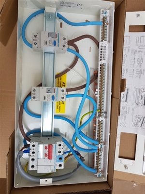

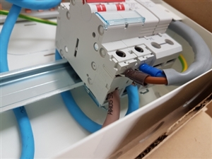

    I'm doing a new installation labour only,  this afternoon I unpacked one of the new Hager CU that they have bought for me to install.
    The is the first CU I will fit with SPD and it's factory fitted, not quite in the way I was expecting , I thought it needed a MCB upfront of it and I wasn't expecting to see it connected into the main switch as it is.

  • I thought it needed a MCB upfront of it and I wasn't expecting to see it connected into the main switch as it is
    Those sorts usually have a one-shot thermal fuse in them (that if broken, cause a red bar to appear the window). This allows it to be used without MCB as long as the upstream device is "good enough". For example the Wylex SPDs that come in their CUs don't need protection if the upsteam fuse is <= 125A.
    As an aside - I'm surprised by the orientation of that Hager SPD - if it had been manufactured with L,N below and E above, all three connection leads could have been substantially shorter, and for transients, the inductance of the leads has a large effect on the voltage that is passed through. For example, a typical type 2 SPD might achieve down to 1.5Kv across its terminals, but add in 1m of L+E leads, and that might increase to 3kV at the other ends of the leads. So rather than 1.5K reaching equipment, 3kV reaches it. It looks like maybe 30cm of unnecessary cabling there, which might be letting through another 0.5Kv.
