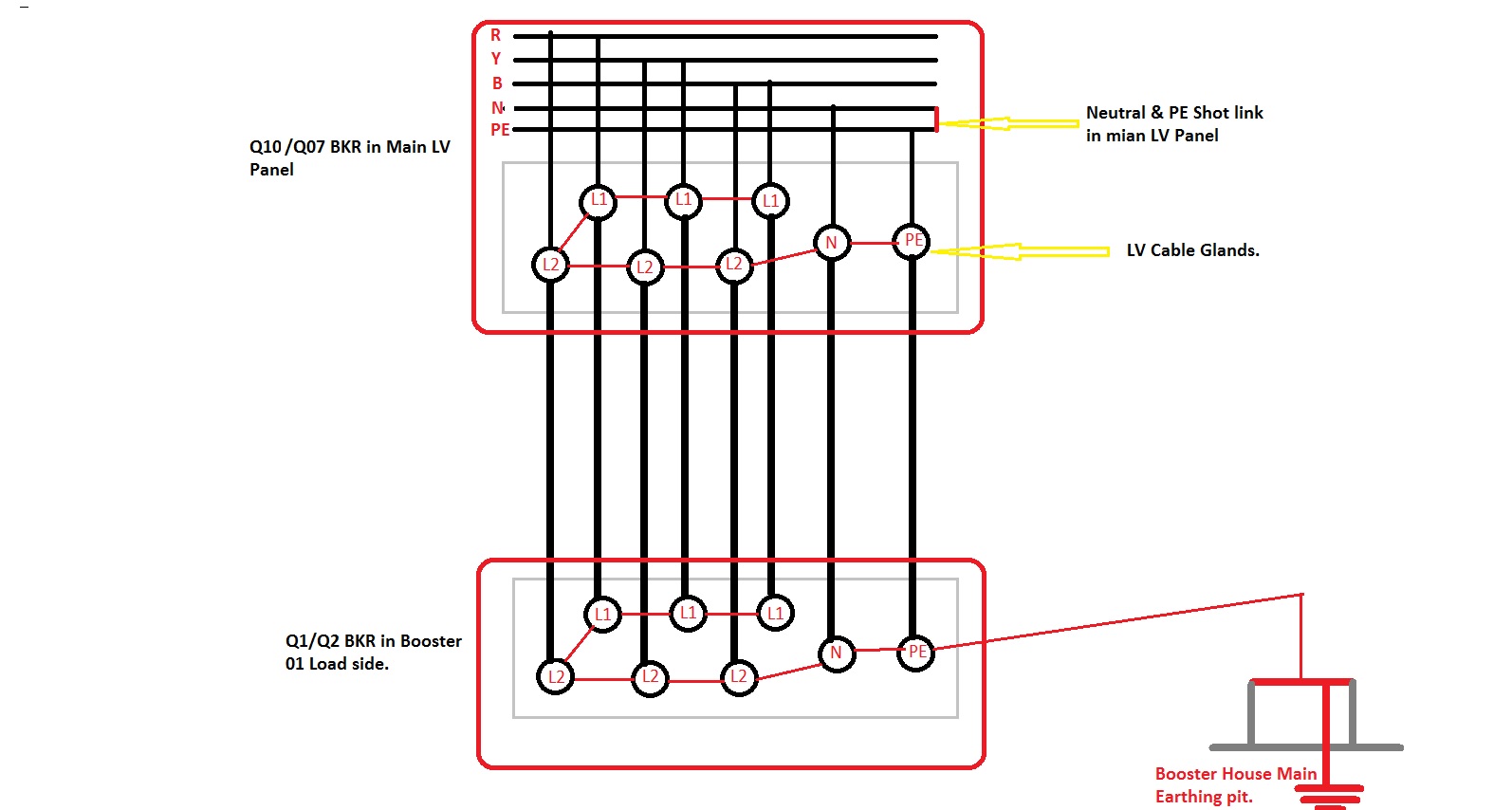

  • Hello.
    Renewal of the glands is big task as the plant application is very critical & can't be stopped for the gland modification. Really the choice of gland material was not good.
    For the time being we are thinking about proper gland earthling & also i made one drawing for that. Hope it will resolve the heating impact after proper grounding of glands.
    Pl have a look on attached file & kindly share your comments.
  • I suspect from the photos you posted that the gland plate is ferrous. If this is the case, then changing your earthing arrangements will make no difference. Replacing your gland plate with a brass one may make a significant difference, especially if the old one was steel.
