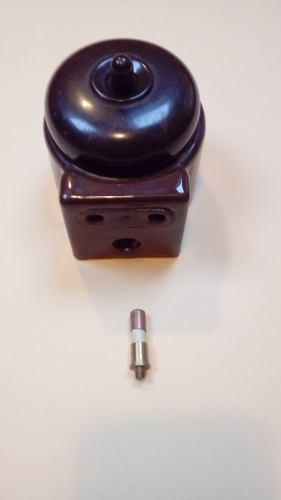

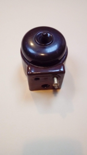

Try ID'ing this accesory removed  from
a bungalow unchanged since built. Possibly 1940ish.  Altough i have seen similar none have been like this.  More pics to follow.

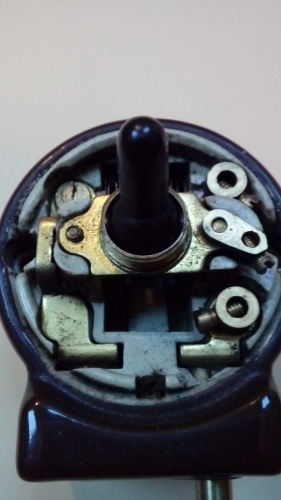

    Close enough Mr Z. And yes the top just unscrews.
    Its a surface mount single switched 13A socket. Designesd for a 3pin plug where the fuse actualy plugs into the socket. Very heavy and the switch has a reassuring action. Made by GEC. 4e5b424dd306e6676475798899531f23-huge-20181129_100837.jpg
    Probably designed for days of yore, requiring a positive switching action for D.C. switching and not microgap as nowadays
