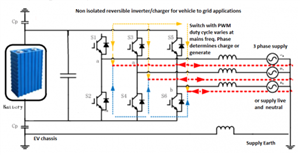

    In that diagram yes - however I'm given to understand that's not the case with all EVs - as some don't have an isolating transformer in that position, but rather like some 'transformerless' PV inverters - use a direct connection or dc-dc converter - for reasons of both weight and efficiency.  (I'll try to dig out some evidence for that.)
  • Certainly transformerless  designs like this diagram are at least being prototyped, and mentioned in patents and R & D publications, if not in production machines yet.  During charging the battery is disconnected from the motors, and its wiring is then good enough to qualify as basic insulation. Rather like the old live chassis TVs of yore, without product standards, the techniques used are driven by price alone. I'm not that keen on the idea from an EMC perspective either, as the whole car now flaps up and down with the PWM fast edge rate, creating a whole RF comb of interference. It would of course be possible to add multi stage L-C filtering to the DC battery bus, but I can see it being value engineered away to a minimum if at all possible.
    The transistors switch at about 40-100KHz, but the duty cycle of that near square wave is modulated to give an average value that tracks the rise and fall of the mains cycles - with a mean voltage below it it to charge, and above it to generate AC from the battery, much like a VFD.
