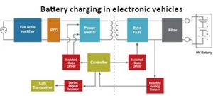

  • Could one of you please draw a circuit diagram showing the electric car and battery and voltage, the DC leads; the main transformer/supply, diodes and protection fuses or circuit beakers with earthing lead arrangement so that we can all understand what is required to construct a vehicle charging station safely.  Please avoid using and initials like PME, YY or CPC  unless their are defined in words. Thank you.
    These are all available in the relevant standards for EV's, EV chargers, and the vehicle-charger interface.
    The term "PME" and "CPC" are standard terms in BS 7671. "YY" is a cable type, and appears in the On-Site Guide.
    These are all standard terms !
  • Firstly understand that the charger, which may or may not involve a transformer and diodes, is in the car, and as such is different for each model.
    Generally mains is rectified and then sliced with power transistors to provide the waveforms required to charge the batteries on that vehicle, whose number and charge characteristics are again similar but different for each model
    e.g the Zoe has a 400V battery made up of 2 paralell strings each of 96 cells in series.
    The Tesla 3 has contains 7,104 cells arranged as in 16 parallel banks each containing further parallel strings  of about 350V each.
    There is no 50Hz isolation transformer as such,  the switching frequency is supersonic. These block diagrams of what is in a typical car may help
    All the current generation of charging  points do is  to close a contactor to provide a connection to the mains when certain interlock conditions are met.
    If you understand circuit diagrams, this here is a delightfully simple but fully standard compliant example of the sort of thing you may have in the wall box, and is in the public domain.
    Better still there is a full description of how it meets that standard also on the web here
