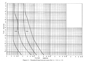

    If the socket has a BS 1363 plug fitted with a BS 1362 fuse rated 13A then it could be supplying 20 for a significant period (>3hours). Take a look at the fuse characteristics
  • true - 13A fuses and 16A breakers do not really discriminate,  (13A fused spurs might actually have closer protection if they were wired up with a 16A MCB instead)  but that is what we mean by a 13A circuit - one that can take 13A all day, but cuts off after some rather indeterminate time at 20A, and the cable rating reflects that (hopefully), in that a cable rated for X amps continuous, can carry a few times X for a short time.
    (fuses have the nice feature of not jamming or welding, and not having a problem with not getting faster with larger fault currents, so are better for dead shorts, - a disconnection is pretty much guaranteed, only the number of bits of busted ceramic to be swept up afterwards rises with the PSSC.)
