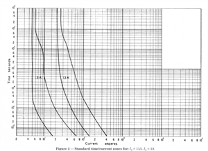

    If the socket has a BS 1363 plug fitted with a BS 1362 fuse rated 13A then it could be supplying 20 for a significant period (>3hours). Take a look at the fuse characteristics
    No it can't supply 20 Amps for hours. These are apparently single 13 Amp sockets for individual dedicated appliances like a cooker extractor hood and fridge freezer etc., so the loads are fixed. No overloading can occur.
