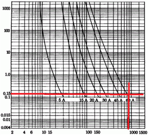

  • Just wondering what peoples first thoughts are on a 6mm main earth. 0.27ze, TNCS. 80A 1361 main fuse.
    A rough calculation (0.3s disconnection time with an earth fault current of around 850A) suggests it'll pass the adiabatic with ease.
    So that only really leaves PME diverted N current considerations. If there are no installation level extraneous-conductive-parts (or a 2nd DNO supply) then it's not really going to be a problem, if there are then if there's no sign of any thermal damage to the 6mm2 then it's probably acceptable (but below current standards).

  • Andy,
                    where did you get your 0.3S from please? From a Fig 10 of the 15th edition for an 80 Amp B.S. 1361 fuse and 850 Amps, I got about 0.7 second.
    Z.
  • Andy,
    BS 7671:2018 appendix 3 Fig 3A1 (admittedly that's to BS 88-3 rather than BS 1361 but as it's a direct replacement standard it shouldn't be too far different) - double checked by the inset table - 850A falling between the 960A for 0.2s and 800A of 0.4s.
    I admit I really should have looked up a proper BS 1361 table - I know the BS 88-3 values aren't exactly the same (indeed a few of the ratings aren't), but I'd be surprised if wasn't in the same ball park.
  • 850A is very quick if you take the right 1361 curves. In general at a ballpark rule of thumb for anything simple and hot wire based, at 10 times the normal 'no break' rating,
    you pass the 0.4 secs required for TN isolation. we are well over 600A, and speed goes as the square of current in this region. even with 3036  the rule of thumb is only a factor of 2 away.
    conclusion, if it was only blowing the fuse we worried about, 6mm will be fine.

  • Mike, the main fuse is an 80 Amp. B.S. 1361 cartridge fuse. I reckon that it will open in about 0.7 seconds for an earth fault of negligible impedance, with a fault current of about 850 Amps. Does that sound about right?
    Z.
  • Ah sorry, I highlighted for 60A - we need to look at more like a 600-650A fault current on a 60A curve, to see roughly what 850A would do on an 80.
    I reckon with a squint it could be nearer half a second, though I don't have an 80 A curve.
    One of the things with fuses, as opposed to MCBs, is that the degradation in breaking time with falling fault current is much smoother variation- a breaker will either do a near instant trip, or you are relying on the much slower thermal part, so there is a hard limit, and at fault currents below that  'it's all off in a heartbeat' is not true. (and for ADS for safety of life its getting it off in a fraction of a heartbeat time that matters.)
    Also in any case from the adiabatic point of view there is no problem with the single insulated 6mm.
