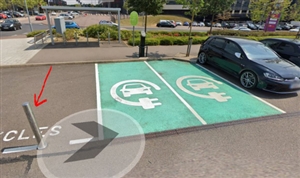

    I see this is an old thread but it has been interesting reading. 7.3 of the IET guide states that EVSE should not be installed in a location where the equipment itself or the vehicle on charge is less than 2.5m from any exposed metalwork connected to true Earth. In London and any other urban centre this gets pretty difficult - street signs, cycle hoops, bollards are all planted in the ground. However these will generally be encased in concrete. How should it be determined whether these are truely connected to Earth?
  • However these will generally be encased in concrete. How should it be determined whether these are truely connected to Earth?
    The text book method is to insulation test (500V) between the part in question and a known good earth (e.g. a supplier's earth terminal or a previously tested TT electrode) - if the resistance is high enough to prevent a shock current then it can be considered not to be an extraneous-conductive-part. Commonly the value of 10mA is used - hence looking for a resistance of over 23kΩ, although in some situations 0.5mA might be preferred (the threshold of perception) in which case the limit would be closer to half a meg.
  • Former Community Member
    0 Former Community Member
    Example here. The bollard is within 2.5m of the charging bay, should it be bonded to the TT earthing arrangement of the EVSE?
  • Well if you measure its resistance to earth and it's over 23kOhms then probably not.
    If it's under then a bit more thinking is needed. If you considered it the equivalent of a highway environment and the EVSE an item of street furniture then maybe you can omit bonding under regulation 714.411.3.1.2. Otherwise it seems that bonding would be required. The trouble then is that if the bay next to that one has a similar item, with not quite 2.5m clear between them you might feel the need to bond that as well, and so on right across the car park... which might start to feel a little silly.
