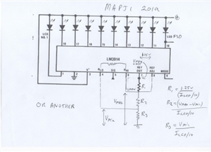

  • Not sure I follow your diagram. I'll sketch something tonite.
  • Cheers Pal, that is a coincidence, I`m not sure that I follow my diagrams either LOL. I am confusing meeself meethinks

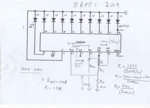

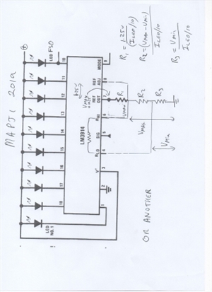

  • Sorry for delay, busy day involving a defective boiler. two bias methods to compare, one better for low level signals, and another better for bigger signals as the REF voltage gets uncomfortably high if the upper level is more than say 5V. E and OE as they say..
    Depends a bit on your supply voltage as well as range of signals.
    Given the tolerance between identical chips of the 1.25 V reference, and the variation of the built in resistor chain, if more than 10% precision is needed, then it will need trimmer resistors that are tuned up individually for each chip. (a trimmer of say 470 ohms in series with 1K for a nominal 1.2k gives a well centred adjustment, and cannot do damage if wound to minimum)
    Given that, for fixed levels the nearest 5% resistors will be as good as some funny value. Hope you can read the writing for the formulae
    Not that actually the nominal ratio of LED current to reference chain current is more like 12.5 than 10, as I drew this without looking at the book, sorry, but it matters not a lot - the resistor ratios are what sets the max and min thresholds.
    ONE WAY
     OR ANOTHER

  • rotated the images and reloaded this morning, as the forum SW cant handle that.
    and again
    These formulae ignore the loading of the in-chip resistors on the ladder values, but the current in the main branch will be 1mA or so for 10mA LED, and the ladder is  going to be a couple of hundred uA or so, an error of 10% ish. The middle resistor needs increasing by a similar fraction to compensate.
