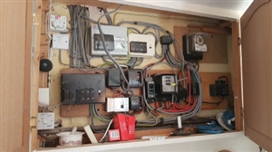

    Thursday's job, install a supply for a shower booster pump, apparently metering services sent a guy to fit a smart meter, but he passed on doing it.
    Too many issues to deal with to worry about doing more than an earth loop test to confirm that there is an acceptable earth connection at the point the new connection has to be made for the booster pump supply.
    Spot the Crabtree 50-50 double pole shockproof switch-fuse.
    Then spot the earth fault protection for the farm building supply on the far right, bearing in mind it's all TT.
    An earth loop tester that trips RCDs is about as much use as a chocolate teapot when you're out on a job snd need to crack on with things.
    Andy Betteridge
  • Yes a nice setup. You've got everything you need....
    Earth fault protection with the VOELB
    Over current protection using BS3036 fusing elements
    A good supply of candles
    Lots of 16mm2 tails
    Although, I might want to check the the maximum demand before I added an extra circuit
    Legh
  • The house  VOELCB appears to operate satisfactorily, however there was originally a second intake and meter for the farm buildings, when these were removed and the farm buildings were connected to the house supply no one bothered with earth protection.
    This is going way off the subject of the original post, but going back to what I said above, when faced with installations like this the last thing you want is to waste time trying to determine something as simple as the earth loop impedance on a circuit.
    So as it stands I’m hanging on to my dedicated two wire no-trip loop tester despite having a new MFT. But that still leaves several other surplus testers that my wife thinks I should get rid of to clear some space.
    Andy
