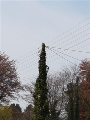

  • The insulation of the overhead supply cables is quite thick, and it is unlikely that the supporting buckle clips were the cause of the clicking on the radio. The clicking was probably caused by switching of lights or heating etc. possibly even loads on timers. Of course there may have been a loose connection at the top of a pole due to corrosion or wind vibration.

    I agree this sort of line-up is getting pretty rare, if it was round here it would probably have become ABC (Aerial bundled cable) by now, they are actively trying to eliminate the overhead bare singles , especially ones with flying crimps like that pole has on the 6 wires that leave to the right. I am pretty sure  those 6 bumps are crimp tubes with no strain relief -  as it is now, really a new PME feed should not be taken from such a pole, as the single flying crimp in the neutral acting as a PEN is not adequate (not being a double fault to danger.).

  • 3 wires come into the building.from the outside, and so I would have said TN-S overhead or TT split phases  but mostly  I think TNS.
    Though maybe not clear as it looks like either something odd has been done with the earths and neutral at the cut-out, or more likely  that all 3 wires LNE duck down behind the board to supply another cut-out on the other side of the wall as a loop through supply.
    Hopefully there is not an un-needed NE link or an NE transposition, unless this is an odd way of implementing a double fault to failure on TNS upgraded to  PEN.
    Now the pole will be L1/L2/L3/N /E and presumably the 'spare' is a street lighting timed live, so that supports a TN-S assuming it has not been retrospectively PME'd.

  • When I pulled up to park outside of the bungalow there were two DNO linesmen parking up to work on another supply cable off the same pole that supplies this intake. After looking at it for a couple of minutes I went back out and to ask them what the earthing arrangement is, but when I saw the overhead cables the penny dropped and I realised what it is, the linesmen laughed when I said I have traveled the length and breadth of the country but never actually worked on an installation with this earthing arrangement before on overhead supply cables.
    The jobs a good one and in theory is quite acceptable, though may be due an upgrade.
