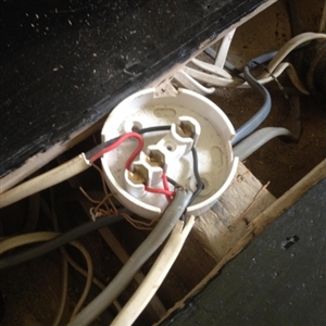

    I rewired the lighting on my house using Surewire light and switch junction boxes in a more radial than loop-in topology. It's quite an elegant arrangement with only one cable to the light fitting and one cable to the switch, but are there any better methods? It has a notable disadvantage that it doesn't supply a neutral to the switch.
    An electrician criticised my unconventional rewire with 'large' junction boxes under the landing floorboards and asked why I didn't just use loop-in wiring with ceiling rose junction boxes. I replied that I hold the view that ceiling roses should be easy for residents to replace so they should not contain a complex and intimidating interconnection of wires where connections also affect downstream light fittings as well as the one in the room. Also the potential health and safety issues with working with complex wiring at a height whilst looking at it upsidedown. He still wasn't convinced and thought that I was wasting my money on the junction boxes and an extra few metres of cable, as ceiling roses will do the job just as well, as well as confusing electricians in the future who expect to see loop-in wiring.

    I've never thought of Roses as being unsafe, they seem fine until people start trying to terminate more cables into them than their design or do you mean working on them at height?
    Most modern light fittings are designed for a ceiling with just one cable. Rarely is a terminal strip incorporated in order to replicate the terminals in a ceiling rose. Therefore the installer ends up having to use a chocolate block to make the connections. More often than not there is insufficient space in the light fitting to contain the chocolate block so it ends up being shoved into the ceiling cavity with exposed live parts. A very shoddy and potentially dangerous arrangement.
    There is also the controversy of a permanent live terminal in a ceiling rose.
