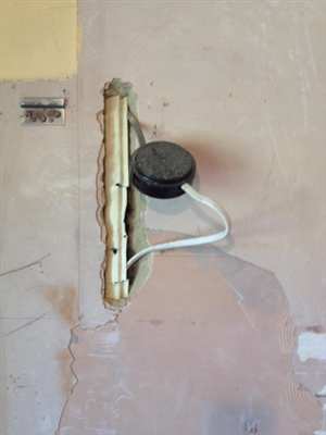

    Here is one that I found earlier. This badgery was revealed when a cooker hood was removed. The photo doesn't show it, but there was a socket about 8" below.

  • That photo example from Chris is an ugly mess but regs wise OK - after all the terminals are enclosed, the only wiring out of the direct route is surface visible, and it is readily accessible, so does not need to be maintenance free.
    Had the JB been hidden by being plastered in it would be  different matter - I remember these images from a thread on the old forum from AM as an example of  stretching the definition of screw terminals joints being accessible with tools.
    http://ancient-mariner.co.uk/public/IMG_0749.JPG
    http://ancient-mariner.co.uk/public/IMG_0750.JPG
    http://ancient-mariner.co.uk/public/IMG_0752.JPG
    the problem with the original proposal is that the change of direction  will be buried.
