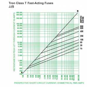

    Hi Mapj1,
    Thanks for the reply. However, I don't agree with the statement above. Peak cut-off current, hence energy limiting is likely to be considerable at most fault levels. Especially at the rated maximum (6kA) breaking capacity.

  • Sorry - I agree I was a bit fast and loose with that one.
    What I was trying to say, and didn't make at all cleat,  is that there is no equivalent to a curve like this  one
    For the BS1362. So we do not know where along the line of increasing PSSC to assume a departure from a constant I squared t.
    The only safe thing is to assume a constant energy (I2t = constant) and no roll off at high fault levels, and no effective reduction in PSSC down stream of it. Though I agree it is not true.
