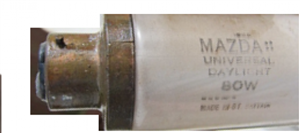

  • For those who have not seen them.
    there cannot be many left - I do remember being told to beware of beryllium oxide   in some early tubes and not to break them. Not sure how real that risk actually is though.
