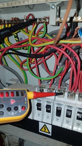

    One from this morning.
    Andy B.
  • Failure to comply with 134.1.1 doesn't really merit a code, but apart from the cross connexion somewhere, that's a right old snakes' wedding! To my way of thinking, it takes very little extra effort to be neat and tidy.
    What code did you give? C2 or FI for me.
  • Sparkingchip:
    Andy B.
    Reminds a bit of that old chestnut. Two rings, one leg of each ring into one fuseway and the other leg of each ring into another fuseway. Quite entertaining and a good prove dead example
  • So you are inspecting (a sample of) sockets. Do you prove each and every one dead before you give the wires a wee tug; or perhaps just the first one?
  • IMO - no code, update labelling on the DB for clarity, order volt stick.

    Unsurprisingly the issue involved the 32 amp MCB to the right hand side,the two conductors that had continuity ended up in the 32 and the rest in the 16. I only wanted to connect the new brown conductors that’s in the top of the picture.
