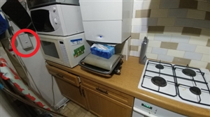

    I'm not sure what sort of pictures you had in mind, but here's one of the switch for the shower circuit (the shower being in the adjoining room). The switch spends its days in the "off" position. None of the appliances in the picture live on the circuit controlled by this switch.
    Thank you for the photograph. I feel obliged to make a couple of observations (with all due respect):
    (1) It is not a large property, so a shower for emergency use seems a little lacking in credibility;
    (2) There isn't a lot of room for a double oven. I also note what appears to be a stack of at least three microwaves. ?

    Oh dear it seems that a picture is not always worth a thousand words :0(
    I'm not entirely sure how your inferences were derived regarding the size of the property, or the "credibility" of a shower for emergency use - I'm not entirely sure what was meant by that?....
    But to clarify:
    • The property is a 3-storey townhouse. I'm not sure what your definition of "large" is, but my guess is that the average UK homeowner would not describe it as "small"
    • The photo shows a small corner of a reasonably-sized kitchen (approximately 12 square metres)
    • There is plenty of space for a double oven to replace the existing single oven (I don't see much value in another photo to illustrate this particular point)
    • The property has three bathrooms - one on each floor. The photo shows the kitchen on the middle floor. The adjoining bathroom is used as a WC, but also has the electric shower in question, which was installed 10 years ago, specifically as a backup in the event of a boiler failure. The associated power supply was installed at the same time.
    • Those are indeed three microwave ovens - well spotted.
    I'm not entirely sure how/whether any of this is relevant, but I guess more information is usually better than less....
