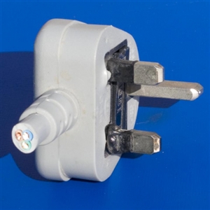

  • This plug (with bottom, sides, and top) was on a 3 kW heater. I suspect that the over-heating may have been in part due to inadequate insertion leading to arcing. I cannot see why the pins would run so much hotter than the cable.
  • Interesting that both pins got very hot (well probably over 70C). I wonder what the pins are made of, perhaps high resistance material. Brass is expensive now! I don't see much sign of arcing on the pins, they usually get discoloured and pitted if this happens. Did the socket survive the onslaught?
