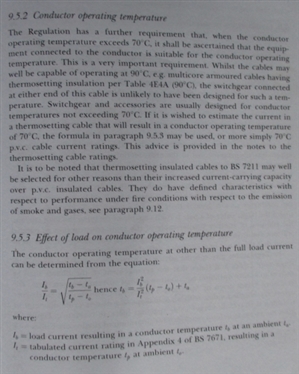

    There's a formula relating the derating of a cable to its conductor temperature (I don't have it to hand but should be able to dig it out if needs be) - from memory it's similar to the one for adjusting voltage drop when a cable isn't fully loaded. I'm sure I've seen it used to justify the use of 1.5mm² MICC cable on ring circuits in one of the IET books - showing that the 70 degree terminal temperature isn't exceeded.
    Anyhow I wanted to show that 4mm² BS 8436 (circular) cable was good for 32A method B with 70 degree conductor temperature - the 70 degree tabulated rating (4D2A) was only 30A, but taking the 90 degree rating from table 4E2A (40A) and applying the de-rating factor from the formula handily gave 32A. On the face of it that sounds inconsistent, but I think the difference is accounted for by (thermoplastic) PVC used in 70 degree cables having a higher thermal insulation value than (thermosetting) XLPE used in 90 degree ones - hence all else being equal the XPLE insulated conductor can produce a little more heat (by carrying a little more current) than the PVC insulated one for the same conductor temperature.

    AJJewsbury:

    I've (to my shame) no idea what the formula is called or where it's originally from. I'm pretty sure it doesn't appear in BS 7671 in this form, although it does have some similarity to equation 6 in appendix 4 of BS 7671 if you strip out all the correction factors.
    I've dug it out - this is an extract from the IET's Commentary on the Wiring Regulations, 16th Ed which probably explains it better than I could ever paraphrase. (it's way out of date now of course, but the underlying physics won't have changed I'm sure):
  • Andy the  Neher & McGrath forumula is explained here
    It includes terms for the temperature gradient across the insulation, and the change of resistance when in use relative to a cold DC reading.  If you allow both if these effects to tend to zero, what is left can be re-arranged from "what is the current at X temperature?", to "what is the temperature at Y current?" , this becomes the same as the forumla used in the IET analysis.
    So Interesting equation I've been searching for such equation for long time.I like the idea to estimate the operating temp of a conductor before even loading it. and the idea is that it's so simple and no need for a software. But Thomas Cook didn't mention a normative or engineering reference or how did he derive this equation.It is vague.
