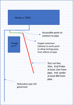

    Hello again. This weekend I have got myself a Peaktech 2700 to test my TT earthing proposals. Whilst it appears to be a nice little tester, the instructions were poor and I used some information from Megger to conduct my tests.
    I have a point close to the garage where I can access the redundant pipe and form a good bonding connector using a U bolt clamp. However, one of the limitations of the tester is cable length, I could not be sure I was getting the mid probe outside of the influence of the pipe due it the pipe runs underground, Hence, I extended the pipe over the top of the ground using insulated 10mm2 copper to give me in effect, a different access point from where I could conduct the test. Please see picture below.
    I conducted various tests moving the mid probe and also going out at various angles. I was somewhat limited due to hard surfaces as to direction of test. My results were great, 28 ohms average and all results with 3 ohms until I moved probe much closer the the outer probe where I started to see an increase. Would value your opinion on the way I have conducted the test.
    However, I may have a problem and would appreciate your view. The redundant pipe is cut off as it exits the floor plate in the house porch. It is in contact with the house floor plate. Do I need to break that connection by cutting pipe off prior to entry to the house?
  • You are doing quite well if your results are within 10% of each other, results like 50+/-20 are quite possible from a batch of tests on the same electrode with the tester spikes moved around a bit, especially with an electrode layout that has no rotational symmetry. and probably water tables interrupted by building foundations and so on.
    In the end the only one that counts is the AC resistance back to the neutral/earth of the supply, as that is what fires the RCDs, and usually you can play a  trick with most of these testers to link things either internally or externally   get into a 2 wire mode were you can do that test too, Maybe the translated instructions are not clear on how.
    If it is easy to do, I'd be tempted to cut the pipe branch that goes to the house, just so you can say the systems are truly separated, though in reality the risk is small - a fault in the house has to make the person leaving the building 'live' relative to ground, and then they touch the pipe that is outside potential - it is not that likely. And actually if a person is at live potential relative to ground as they leave the house then  you have other more serious problems as soon as feet touch the path outside, so it is not the kind of fault condition likely to go un-noticed.
