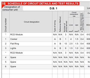

    Re Chris's comment above, here's a snapshot of part of Section 16.
  • Not really a split load board is it, more of 3 circuits on one RCD.  Three RCBOs and a main switch might have been easier to understand.
    Still not an incorrect thing to record, and I can see that is  makes changes like points added or removed since last inspection easy to spot, so probably quite useful. (and obliges inspector to actually go into each room...)
  • Why on Earth did they fit a dual RCD board, and then put all the circuits on one RCD?  If that RCD trips, the whole flat goes dark, and the tenant is left stumbling around looking for a torch.  Putting the lights and sockets on separate RCDs is much more sensible.
  • You have ended up with an idiot electrician.
    It is probably your own fault for not taking the opportunity to engage an electrician and upgrading the electrical installation during the last few years when the flat was empty between tenancies as void maintenance, rather than leaving yourself in the situation of being railroaded into getting work done by the letting agents contractor to comply with legislation.
    The consumer unit layout can be left as it is, but it’s definitely the work of a fool having two RCDs but only using one of them.
    Personally, like Mike, I would have gone for three RCBOs.
  • AlanKay:
    Thank you. Old software based upon obsolete model forms - before my time!
    I do realize that they are model forms and you can add whatever you like to them, but it doesn't exactly inspire confidence.
    God knows why the circuits haven't been split across the RCDs, but the board might well have been cheaper than an RCBO one.

  • VAlanKay:
    I do need to visit. Need to arrange with tenant via MA.
    I had forgotten about this, that truly is the work of an idiot electrician.
