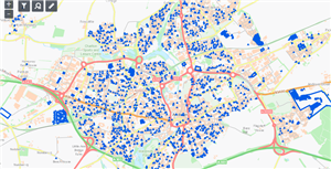

  • At least in some local authority areas anyone can see which properties have had building notices submitted.
    Each blue triangle on this map represents a building control submission in Andover in the last year, some are gas, but most are electrical and in the real map (link here) with the right options set (by zooming and using that funny 'funnel' icon), hovering the mouse over any one brings up the address and the type of notification.
    I understand a number of local areas do something similar, you may be able to for yours
