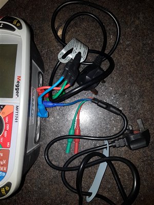

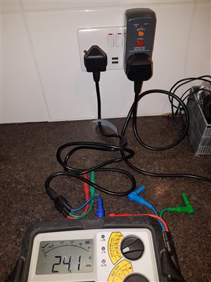

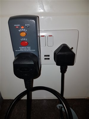

gkenyon:Sparkingchip:
Something like this plus a 13 amp extension lead with a couple of 13 amp tester leads and the caravan RCD can be tested without tripping the site installation RCD.Yes, I like that approach.
Or for a caravan that normally has a 16A BS EN 60309 maybe something like this: https://www.martencables.co.uk/product/marten-pce-230v-16a-plug-to-2-x-16a-sockets-2-way-y-splitter-2-5mm-ho7rn-f-cable/ - with a 16A to 13A adaptor on one outlet, or even substitute a 13A trailing socket.
