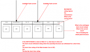

    What do you mean by "the Switchgear"? Do you mean the 'switchgear assembly' (i.e. the switchboard or panel or distribution board,etc.) or do you mean 'the installed circuit breaker'?
    A rating of 50kA @ 1s is generally a rating that could be either.
    In most contexts I would take it to be the short circuit rating of the assembly (i.e. the busbar rating) but if there is the slightest doubt I would suggest asking the supplier/manufacturer for confirmation.

    I meant the switchgear assembly
  • Hi OMS,
    Isn't all this parameters elated to the circuit breaker?
    When someone says, what is the short circuit rating of the switchgear assembly (the whole structure), what does it usually refers to?
    Is it the busbar rating?
    Is it the Main Incomer circuit breaker breaking capacity?
    Is it the whole assembly withstand capacity?

    If the short circuit rating is for the whole assembly, then it's the short circuit rating for the whole assembly - which may or may not be a conditional short circuit rating compared with a protective device etc
