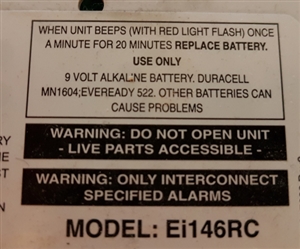

  • Okay, I am using the right kind of batteries.
    So what's wrong with batteries other than alkaline that makes them unsuitable for use in smoke and heat alarms, what is E-Block and what makes a battery suitable for use with transistors?
    Andy Betteridge.
  • Different chemistries perform differently - slightly different initial voltages, very often very different curves as they discharge or age, sometime different performance given large or sudden changes in load (e.g. when an alarm sounds). I had a lot of problems with some early rechargeables for instance as their terminal voltage quickly dropped to a level where some equipment would object even though there was plenty of power left in them, and being labelled with the correct "nominal" voltage.

    what is E-Block
    A generic size.
    It is actually in the singular in your image, as in transistor radio. Don't tell me you didn't listen to 208 under the bedclothes with a 10 shilling pocket sized transistor radio using one of these compact 9 V batteries in the 60's?

  • E-Block is the name in some countries for what we used to call a PP3. The reason they specify alkaline is the long shelf life. Zinc Carbon (or in reality these days Zinc Chloride) batteries are still depressingly common. In the heat of a mains powered smoke alarm (they do generate a little, enough to cause the temp to be a fair way above ambient inside the casing), can cause those to leak in short order.
    It's basically being nice to the consumer, 'don't destroy the thing that might save your life by buying an asda smart price zinc battery'
    Trade price for the 'right kind of battery that you show the box of there is about a pound a unit inc vat round here, hardly a lot for a year's protection :)
