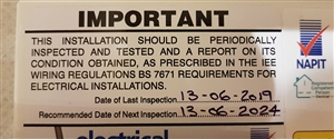

  • The one I have just checked 3/9/2020 obviously they did not get the memo.
    Two new all RCBO consumer unit, it makes a change not to have to type up a long list of observations. Though the bathroom light is going to get a mention.
