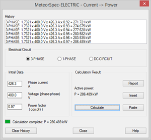

  • Former Community Member
    0 Former Community Member
    Hello Michael,
    I would advise you to use suitable calculators. On the net you can find many free ones.  For example the MeteorSPEC:
    You must to define a summarized power factor for the load. It is usually in the limits 0.92- 0.97 for buildings. Please, see the History list on the window above.
