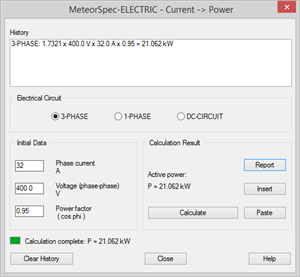

    Yes, with 3x32A main protection, you can supply a load with a total power demand of 21kW with a power factor of 0.95 for a long time.
    With a 3-phase input, the loads of the house can be fairly evenly distributed between phases. Powerful consumers can be ordered in both 3-phase and 1-phase versions. Usually, the main protection is not fuse, but a 3-phase circuit breaker with a C-characteristic, which can keep overloads with asymmetries.
    On the continent, 3-phase input is increasingly being used if the power consumption is more than 16 kW. I can also add that for a house with an area of 120-150m2, the main protection 3x25A is most often used.
