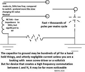

    During a PAT test on a handheld Black & Decker jigsaw, the saw was being held by the tester so he could pull the trigger while his mate pressed the button on the test machine, The jigsaw ran for a while then the meter said it had failed on earth leakage,(1mA)  but this was a Class 2 device with a 2 core cable so where was the leakage going to?
    Surely we can't have a situation where the device would have passed if the tester was standing on a rubber mat or had trainers on and would fail if he wasn't / didn't?
  • This shows exactly what is wrong with PAT in general. A leakage test to real Earth is useless for a class 2 appliance, and should not be carried out. An insulation test to external metalwork probably should be. It is assumed by these supposed "testers" that all appliances are identical, and need the same tests. The persons carrying out the tests know no better, and so it goes on. I wonder what value they got for the Earth bonding to the appliance, was the infinity a pass? PAT should not be an idiots game, it requires competent inspectors in the same way as everything else. Why this reading was obtained needs investigation as there is no obvious circuit. I think at first guess that the tester is class 2 and has an Earth connection whose current is measured during the testing to get a "leakage" value. Stray capacitance from Live to Earth would then give some reading like this. The other alternative is that the saw insulation is faulty, but if this was not measured, who knows?

  • As far as I know the substitute / alternative leakage test is conducted in the same manner as an IR test with line and neutral shorted and tested to earth. The test voltage is around 100v but at 50Hz AC thus permitting impedance to be assessed. The machine then scales the leakage current to 230v. Problem is that electronic switches wont be activated so I guess this is not really a suitable in-service test for most equipment.
  • The problem, lyledunn, with this is that given a class 2 device there is no obvious earth to test it to. Do you use the plastic housing, the hand of the guy holding it or stick a probe into the ground somewhere?
    I'd agree with the above comments that it's probably not a suitable test for a Class II appliance for an in-service test. Where insulation or similar tests are done on Class II appliances for things like type testing I understand that they'd wrap accessible bits of the appliance in foil which is then Earthed (at least in the sense of being connected to the "earth" terminal of the test meter) - and likely placed on an insulating surface, and if necessary any trigger being held in by mechanical means. Probably way beyond reasonable for a routine in-service test.

    From what I understand about how the normal leakage test is done it does not measure the current to earth but the imbalance between line and neutral in the same way as you can use a earth leakage clamp meter.
    Maybe the reading is a false one due to the commutator on the motor.
  • If you have a double insulated drilll with a metal chuck perhaps one can meaningfully measue an earth leakage of sorts, or at least verify the insulation is intact between the motor parts and the chuck.
    The RCD like test (a current transformer looking at L-N currnets) is all very well, but can be fooled, in much the same way as an RCD is sometimes tripped by the failure of a light bulb filament. If the current waveform is jerky, that is to say it contains high frequency interruptions and reconnections, perhaps with peaks many times the average, then the action of the transformer can be/ to not correctly cancel the currents, and to register a peak reading on the secondary that is misleadingly high .f8c1f1f129aaf348ef7921c9ed72be71-original-emc1.jpg
